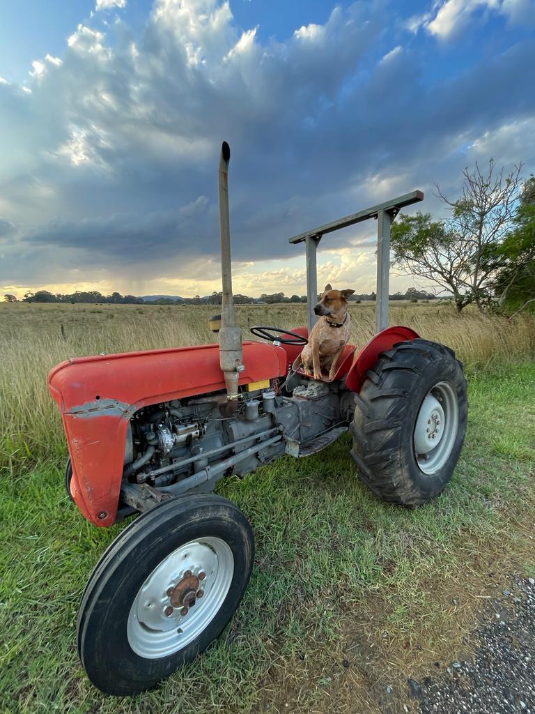

Just thought a photo of my ROPS pre-restoration might help. This one is currently in pieces in the shed undergoing its restoration.

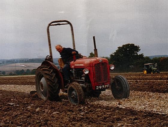

I would steer clear of types where the top crossbar is clamped in place. I had one on a B275 and it would regularly vibrate the crossbar out of the clamps regardless of how tight the bolts were done up. A poor photo but just visible.
This is the bar on my dad's 35x.
