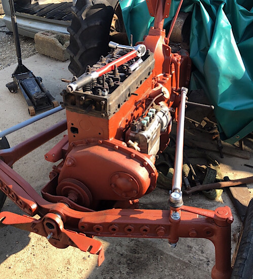

So I’ve managed to do a bit more it not found the time to update this thread.
Head is now on, axle cradle fitted and new bush/pin for the axle beam. New steering joints and foot pegs as the joints rattled and I have never seen so much slack in the foot peg sockets :o
New wheel bearings, kingpin felt seals and hub seals finished off the front end so I could roll it around again,
