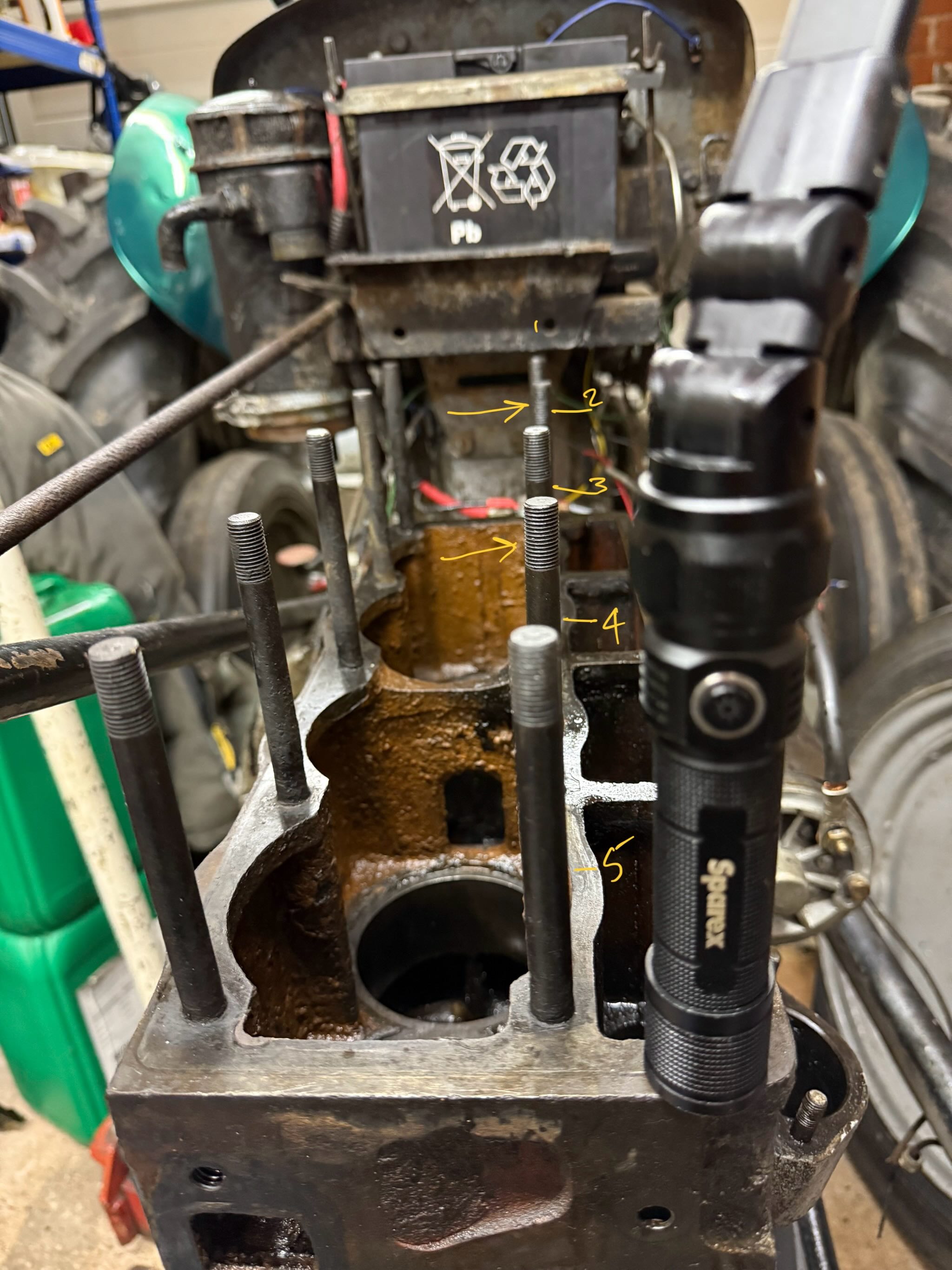

This is now where the advice is required have been cleaned inside the water jacket and the push rod enclosures. I think I can see a couple of little cracks in the block at the base of the studs the bolt the head down, this is at stud two and four. Hopefully you can see this in the pictures attached
It would seem that the studs two and four lean towards push rod enclosures and not vertical in the other picture
So the question is, what's my angle of attack? Do I just put this back together? Not torquing these two bolts down too much? Or do I need to approach it from a different angle and perhaps welded up .
