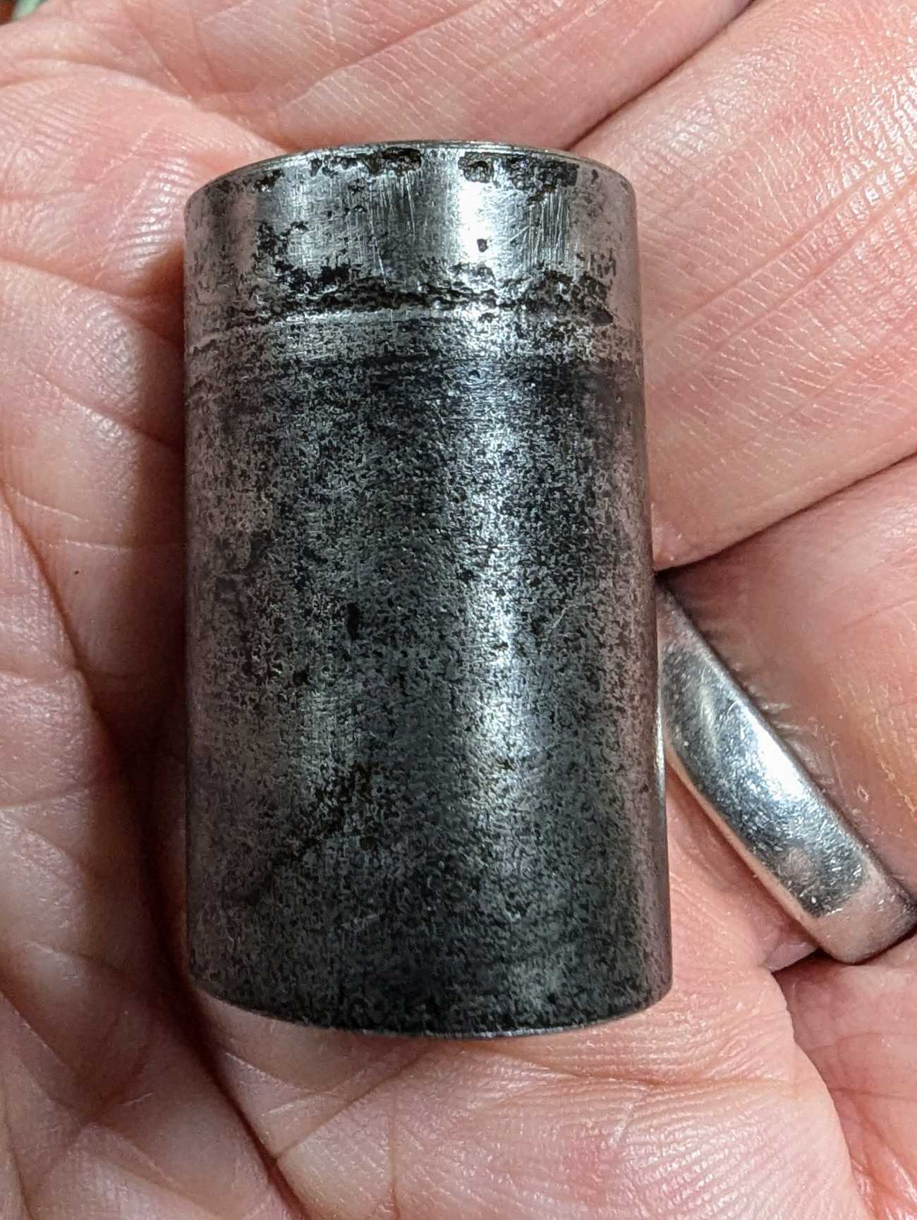

I read online somewhere that you can test the diaphragm and air seal by removing the the inspection plate on the front of the pump and put a finger over the suction port and knock off the engine stop to see if there is any movement/leak. Mine still seems to leak even after a new diaphragm. Can these leak through the plunger /pin that comes up against the diaphragm? Find attached a pic of the plunger.

The little piston in your hand is not very good.
