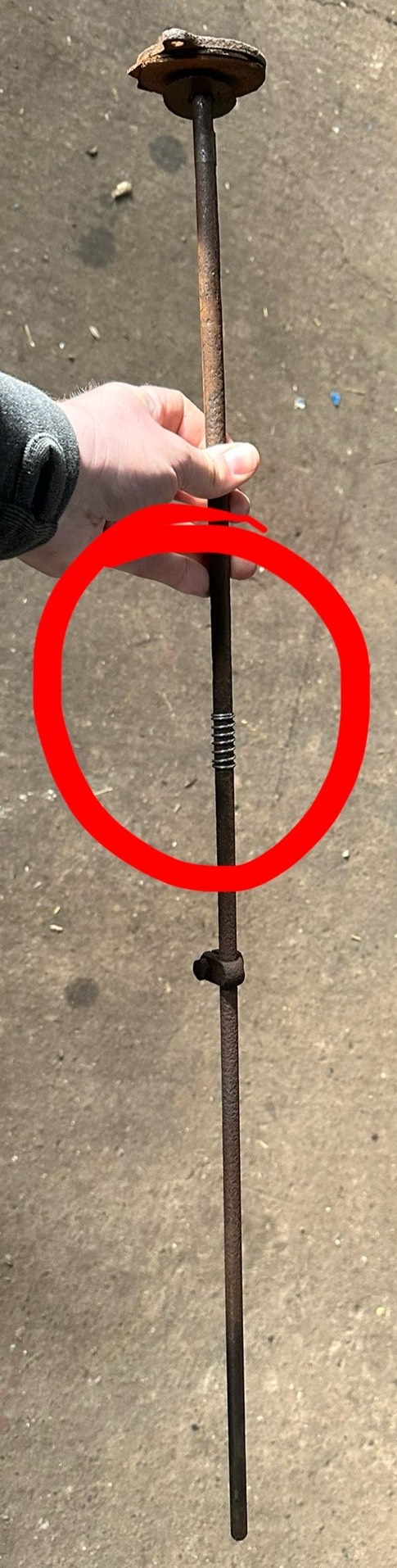

TEA20 Throttle Spring.jpeg (213.33 KiB) Viewed 2641 times
Hi all,
I wonder if anyone could help.
I am restoring a 1949 TE-A 20 and we understand, from the previous owner, the spring in the photo is the wrong one, causing the throttle lever to rattle loose.
I am trying to source a replacement spring (Please see picture above). Wondering if anyone knows or could measure the measurements of theirs for me? Or even better have a product number for a replacement one.

Morning Richard
The spring in the picture is the type required, if its not holding the throttle try a stronger spring and maybe a bit longer. If the cork disc that works as a throttle brake has gone hard it may be that that`s not holding the throttle at the set position.

That’s great. Thank you for your help. I’ll give that a go.
