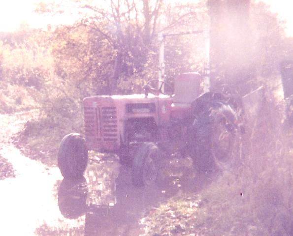

I would steer clear of types where the top crossbar is clamped in place. I had one on a B275 and it would regularly vibrate the crossbar out of the clamps regardless of how tight the bolts were done up. A poor photo but just visible.
IHC B275.jpg (37.1 KiB) Viewed 9791 times
This is the bar on my dad's 35x.
